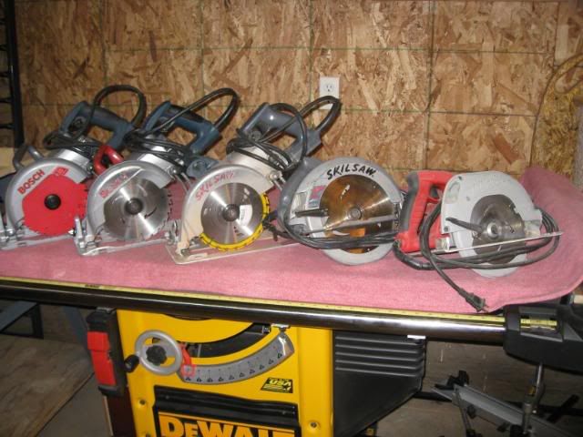

Are you a professional framer where the saw will be used 8 hours per day? If so I have an excellent framing contractor who only buys the best and I could ask him, I know his air nail guns are Hitachi. If you don't use the tool to make a living you probably don't need to buy the real expensive stuff but I know a lot of guys want to buy DeWalt because that's what most of the professionals use. A Ryobi is half to a third the cost and most casual guys will never wear one out.
I used my Skil worm drive for 11 years doing commercial framing. Then gave it to a guy who is still using it. If you are stuck on worm drives, go with the best, Skil.
If you merely need a great circular saw, my Porter Cables ( 6 1/2’ and 7 1/4’)were bought in the 90s and are still going strong.

Huntsman, thanks for the recommendation. I’ll add that to my short list. After reading about it, I’d say it edges out the Skil and Makita. Amazon price is $190, so right in line with the Makita. In the review link I posted, he reviews the Bosch 1677M, and not the CSW41. Prices are similar…I wonder what the differences are?

tlawler, The only difference between the 1677 and the newer csw that replaced it, is the skil-style top handle and the hanger. And different rubber. .... Framing for almost 50 years, I'll take the bosch over the makita, dewalt, milwaukee and the older B&d industrials, and I've owned/used all of them.. And I started using worm drives when they were all metal.....

Bosch it is! I’ve got a CSW41 on the way.

I agree that the Skilsaw or Bosch worm drive is about the best for heavy and long usage. Never owned a Bosch though. When I needed a new circular saw about 12 years ago I bought a Milwaukee (USA made, new-old stock) with the blade on the left side - perfect for right handed users as you can see what you are cutting. While it might not be as good as the Skilsaw or Bosch worm drive, it is smaller, lighter and handier for the occasional use it gets from me. It is also quite powerful and serves my needs. If I used a circular saw more often, I'd buy what Tom just did - or the Skil version.
