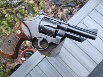

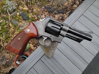

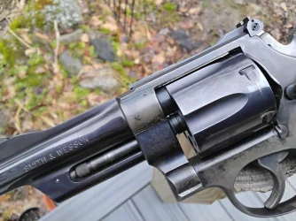

So, after venting and whining, how can I fix this gun? The last photo is of my other HP, showing how the barrel pin should look on a S&W of that era. I want to somehow get the junk and wreckage out of the pin hole and get a pin properly installed, so that it looks, when finished, like an original. So I seek advice and recommendations. My ultimate goal is to get the gun refinished in a decent blue job, and then use it until it or I wear out completely.
The photos show the current state of the project. Note the crappy pin holes, which I have tried to clean up. The gun shoots well. In single action one of the cylinders carries up a little stiffly, but I'll fix that. The balance and handling are everything I have wanted. It's a good gun that deserves being worked up to its potential. Thanks in advance for any suggestions.
I’ll opine that it doesn’t look as bad as I expected after reading the story (and I feel your pain!).
I’m not an expert, they will be along shortly, but it strikes me that the slightly larger pin you mentioned would probably be a reasonable solution; so far as removing the mess (including hider pins in now-blind holes, jeez!) what is coming to mind is EDM machining, which I believe can do a pretty good job in this situation, given an expert operator.

There isn't a lot that can be done for the frame damage. I would make a new .055" barrel pin with ball ends like it was from the factory. Make the pin long enough that it protrudes from both sides of the frame, that would help to camouflage the frame damage to the pin hole area. I would try to polish out the file damage on the left side of the frame and re-finish the gun, probably by the rust bluing you do so well.

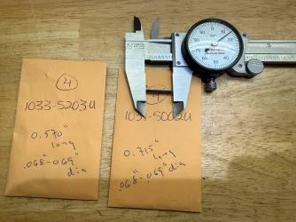

My experience has been the barrel pins are 0.068"-0.069" diameter and vary in length, 0.570" or 0.715".
IMG_5728Gunsmith S&W Revolver Barrel Pin Cup Tip Punch 0.070" Fabrication 04.01.26 copy.webp

If the pins now in the frame that you can see in the pics are soft steel, I would recut from both sides as SteelSlaver says to the 1/16d . But only to a depth to allow short pins to be inserted.
If one end of the pin in the pics is a broken off Carbide bit,,then I would go to the EDM or Laser cut removal.
Trying to cut through that broken off carbide bit with yet another carbide bit is asking for failure.
Forgive me if I am not understanding all this.
If you can work around the issue of the broken off carbide bit being lodged in there, then I would just leave it inside the hole.
Cutting from both sides for a short pin would end the problem.
A short pin inserted from both sides will fix the looks.
Yes it's a cosmetic fix, but so is the Bbl Pin itself cosmetic.
The bbl pin doesn't really do anything to hold the bbl in place. Torque during install does all that..
Some people may not be able to live with the thought of the broken bit piece inside there, then you have to go big and EDM or Laser cut it out of there. You'd still likely have to recut the entire hole a trifle larger (1/16"d) and re-pin.
Those marks around the work site are a simple fix. Small dents can be peened back into place and careful polishing brings the surfaces back looking like they should be.
A touch up bluing to those areas with rust Blue will then finish the job.
