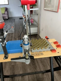

Good advice except for the dedicated space and bench.
I’m in a condo now so I use a foldable work bench with my Lee App press.
As for the rest of your conditions yes, I do enjoy reloading but, more importantly, I shoot .41 Magnums so I MUST reload.

Reloading can be entertaining and satisfying. An actual benched press, even if on a temporary mount, as some PPs have noted, goes a long way in that direction.
