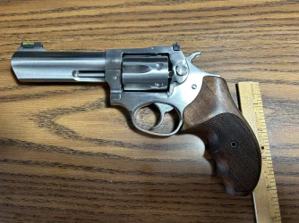

I wanted a 327 for the cartridge versatility. Options and $$ were limited. Wanted a 4" barrel. Ended up with a second hand 4" SP101.
I had thought a GP100 had a heavy trigger, the SP was worse and the gun was so dry it squeaked. Got some Wolff Springs, Shively shims and along with some minor polishing, cleaning, lubing the action improved considerably. Ordered some KSD grips, needed minor fitting, no washers or escutcheons, got some. Grips added a welcome 1/2" in length over the OE. Ended up with a 327 that fit the bill.
