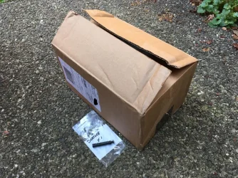

I called S&W and had them send me a new recoil spring assembly, and I just got it today. Take a look at the box they shipped it in...
I almost thought someone had sent me an empty box until I found it inside the bubble wrap. Unfortunately the replacement RSA is actually worse than the original. The spring wants to pop out on both ends, it completely locked up my gun and I had a hell of a time getting it apart again. Time to go aftermarket...
Looks like those Amazon packages where they put a magic marker into a box for a toaster oven. 🙄😂
laughing at the size of the box :D
