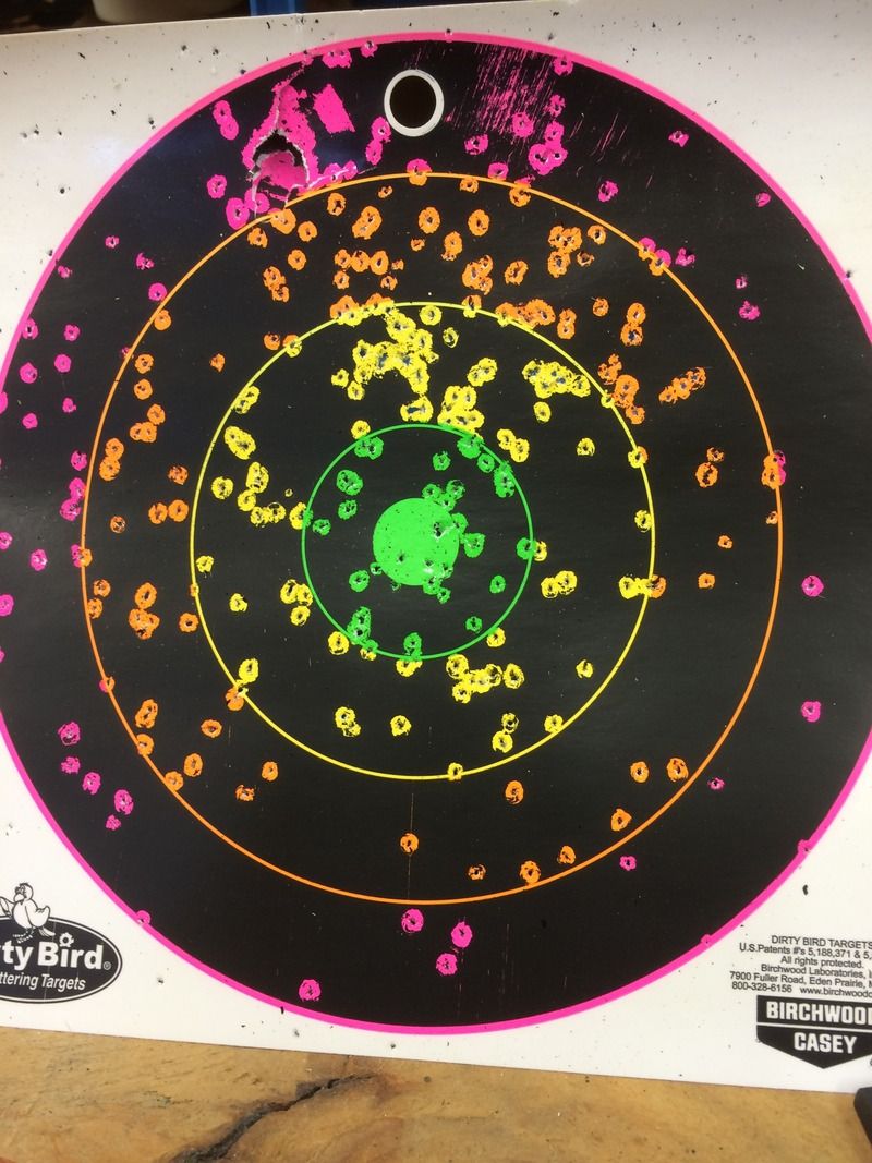

The pattern is pretty consistent. This was at 10 feet.
It feeds fine from the magazine put did not eject completely. I decided to go with some cut down 410 wads. It holds right at 110 grains of shot.

That really looks good. Should turn a snake into hamburger at that range!

Very nice, I'm researching this topic at the moment. I saw a couple ways of containing the shots. One with the paper card board cut out and one with the 410 wad. The paper cut out seems to go with the home made method where a 41 magnum die is used to form the top. The 410 wad is used with dedicated shotshell die set. My question is, can the 410 wad be used with the home made method? I suspect the base of the wad is too big to squeeze in the case for the home made method therefore a paper cut out is used. After making my 45acp, I plan to shot a clay target coming out of the station 7 low house on the skeet field. I think given the pattern shown, I believe the 45 acp shotshell will break the target. Any comments are much appreciated.
Thanks in advance

The .410 wad works just fine with the .41 mag version. You can actually see on the target where the wad hit. It slips right in. I got better patterns with the wad. I tried to crimp with the .45 acp bullet seater die but it was too narrow. I then tried the .500 S&W seater die and it worked perfect. I made the overshot wad out of a gallon plastic water bottle. Using a necked down case that was chucked in my drill press. It cut right through the plastic after putting a heavy chamfer on the case. I did this because I wanted an all weather round without using any type of glue.
I had ejection problems with the case hanging up in the ejection port. Increasing the powder charge slightly didn't make a noticeable difference. I believe it was due to the casing being too long. I may shorten one just a little to see if that helps. They did feed fine from the magazine. Although for my purpose ejection isn't necessary it would be icing on the cake.
I just ordered some 10mm Magnum brass and hope to work on a 10mm shotshell in the next week or so.

Originally Posted by jb19152 View Post
If you're not going to use them very much; I would suggest buying them loaded off the shelf. I'm sure they are available. I have some in .357 mag that I bought years ago. Check with Midway USA. Good luck, dogwalk
These are Shot Loads off the shelf. I only use them on snakes and pesty critters, so I don't go thru many a year, maybe a box, which is 10 rounds. They come in 10 round packs and cost $12.95 last Oct./Nov. at a LGS, so I bought 4 packs at the time.
BTW, at 7' / 10' they are devastating on snakes, etc.
