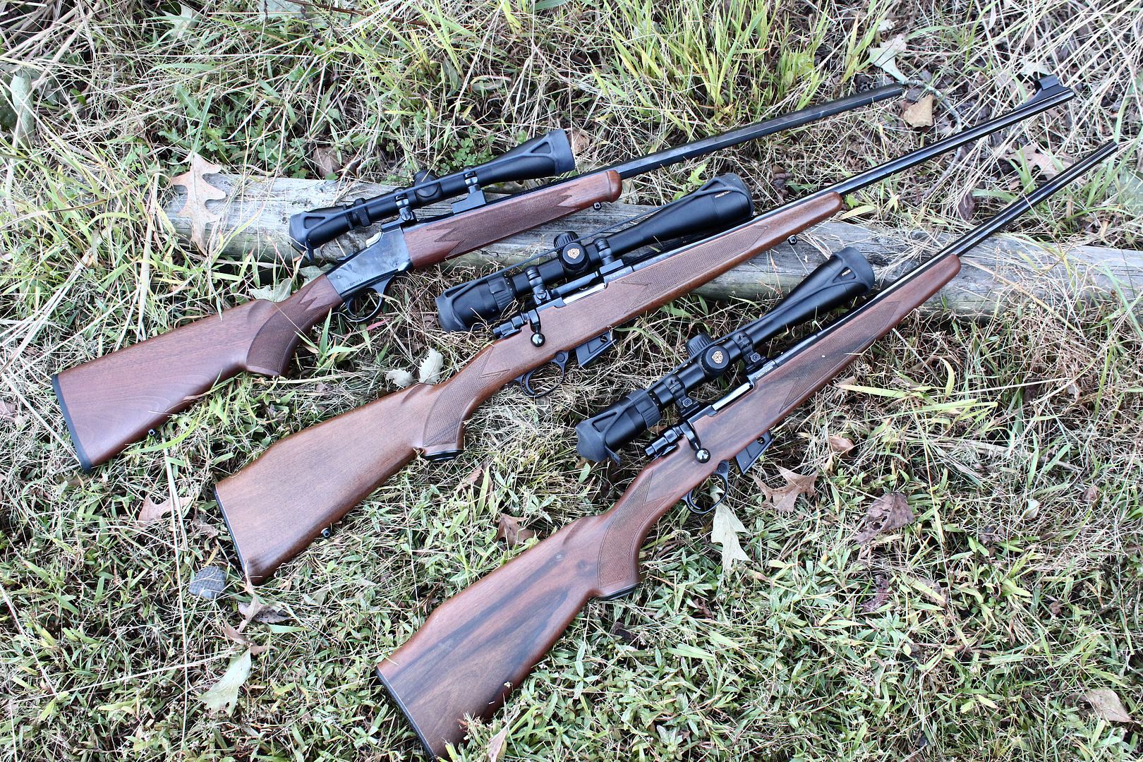

Like BB57 I settled on the Hornet years ago and I bought this Browning 1885 in the mid 90’s. Great little rifle, with ‘lil Gun powder it is very accurate. If I had a .218 Bee i would start with that powder.
Here’s my Hornet, and, yes, I bought it for the wood. 😁
