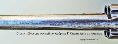

The barrel rib address line seen on all First Contract Russians
The address line contains the following text in old (pre 1917) Cyrillic letters:
Смита и Вессона оружейная фабрика Г. Спрингфильдъ Америка
This translates to:
"Smith and Wesson weapons factory C.(ity) Springfield America"
