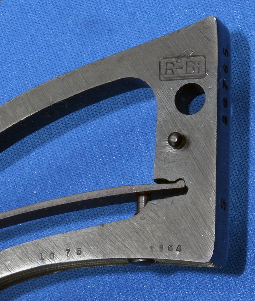

I'm no expert but there may be star on the butt which is usually associated with a refinish. You may see R-N meaning refinished to nickel from blue. There is often a date on the grip frame like 8.75 meaning the work was done in August of 1975. A stamp on underside of barrel may indicate a barrel swap. Most often the exact nature of the work is unknown and that can be frustrating.
This stamp is for a refinish in nickel, regardless of original finish. Other stamps include "R-S" aka refinish - standard (blue), "R-B" aka refinish - blue. Other times a diamond with a "B" inside is seen for refinish in blue. Barrel rework markings were often a diamond, which indicated rework or replacement. Sometimes the serial number was re-applied, sometimes not, depending on when the barrel was replaced. This is also true of the cylinder. Sometimes a "S" with a diamond is found, instead of just a diamond marking. Date codes are sometimes 6 digits, such as 10.17.39 although they are normally month / year. Sometimes a star is by itself, sometimes a date code is by itself (on the grip frame).
S&W discontinued marking the guns when reworked either in the 70s or 80s. I called them and asked this very question a few years ago when I was having a 27-2 re-plated. They informed me that they do not presently mark the guns sent in for rework / refinish in anyway. Since the details of the rework was filed under the sender's name, and not the serial number (except perhaps in rare cases), the work which was actually done is largely unknown today.

I guess my pre war 44 did not get the memo! Now technically this is a 5 digit code, but anyone can see, that in the way they did this code, if it was done in say, October, for example, it would then have been a 6 digit code!
Hopefully Lee never tells you to jump off a cliff! There would likely be disastrous consequences observed! ;)
Lee wrote rework date stamps that included the day of the month were faked. Other than saying that I would not bet my money that they are authentic I do not know which of you is correct.
Well there is no way that date code on my revolver was faked! The gun also has a circle P stamping, which refers to re-plate.
The one in the picture above is date stamped 5 29. There is no dash and it the spacing between the 5 and the 29 is about the width of thee to four digits.
of course, this was back in May of 1929. S&W could of worn their punch tools out and had to acquire a new one after a half a century.
