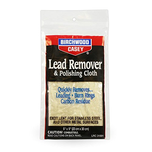

I've owned several stainless steel Smith and Wesson revolvers over the years, and the absolute best thing I've found for cleaning up the finish, and keeping it looking like factory original is by using Birchwood Casey's Lead Remover and Polishing Cloth! This works wonders for removing the lead flash buildup on the front of the cylinder as well. You wouldn't think so, looking at it, but trust me, this works great!
Birchwood Casey Lead Remover and Polishing Cloth
B/c Lead Remover W/ Cloth 6x9
I've also cut patches out of these to clean barrel and cylinder bores. Talk about getting them clean! And nothing compares for cleaning the end of a cylinder. Just don't use on a blued surface as it will take the bluing off.

Used these on my stainless revolvers for years as well, both inside and out!
