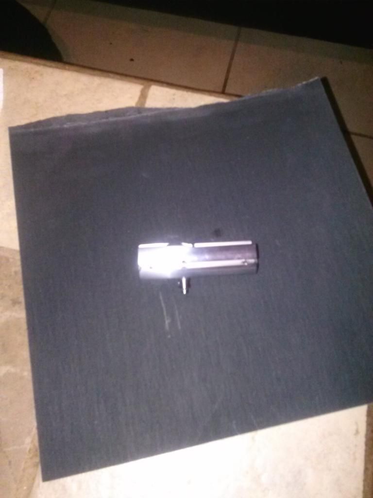

how do you remove the spring assembly from the bolt so i can polish the bolt?
Taurus 9mm,M&P 15-22,RRA AR-15
Reply With Quote
You have to compress the spring manually, then lift the spring bar out of the notch in the bolt carrier. To reassemble, just reverse.

i just polished my bolt and am starting the rails now.my bolt wasnt too bad so it only took me about 30 minutes.the flash kind of washed out my pics but you can see its shining like jewelry(well almost).here are the pics.

Nice job on the bolt! Polishing isn't difficult. For you guys that are hesitant to try it, you could probably find YouTube videos showing some polishing instruction. But probably not for bolt guide rails specifically.

i just wet sanded(added dish soap to paper and steel wool) using some 600 grit paper for the first pass,then used 000 steel wool,then 0000 steel wool(always keeping wet)

Just got through polishing the rails and bolt. Both are alot smoother than they were, but I'm not totally satisfied. I don't really have the materials on hand to do it just right. However, it's good enough for now.
There is alot of really good info on this site, you guys really seem to know your stuff. I've really learned alot, and it's well appreciated.
