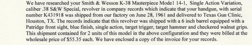

2. Factory SAO K-38 Masterpiece revolvers were produced in the 14-2, 14-3 and 14-4 variations.
Jack, SAO was also available for the 14-1. When I bought mine, it had a very nice double action trigger. Imagine my surprise when the letter from Roy arrived informing me that it left the factory as a "Single Action Variation" on June 28 1961.
Since the -1 ended and the -2 began sometime during 1961, maybe I have one of only two factory SA 14-1s in existence. ;)
