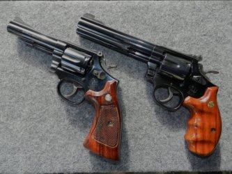

Actually the Model 15-5 , 15-6 and 15-7 changed to the wide rib Model 14 barrel available in 4",6" and 8,3/8" and the Model 14 got a new full underlug barrel in 4" and 6" ( not sure about 8,3/8")
Shown below are a wide rib 15-7 Left and a full underlug 14-6 Right.
