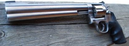

Here's a 647. Shoots fine but I don't use it much. Bought it when I saw it as there are so few available and have never seen another for sale. Kind of like my one and only Taurus; the also not often seen Raging Hornet. Interesting but not the most practical of handguns.

Is there a mechanical reason for a full lug?
To me it makes it look to large for the caliber
