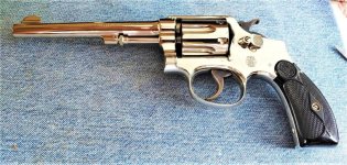

Looking for some help identifying this .38. It was my grandfathers and I was told he carried it when he was a volunteer policeman in a logging town in Washington State in the late 40's and early 50's.
Yoke # 1243
S/N 81307 (It matches in all three locations.)

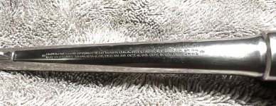

Barrel Patent
SMITH & WESSON SPRINGFIELD MASS. U.S.A. PAT'D APR.9.89. MAR.27.94. MAY.21.95. JUL.16.95. AUG.4.96 DEC.22.96. OCT.4.98. OCT.8.01. DEC.17.01. SEP.2.02. JULY.7.03
.38 S. & W. SPECIAL & U.S. SERVICE CTG'S
It does not have its original grips, it has some large plastic grips on it. Any suggestions on where to find more period correct ones?
Thank you for any info you can provide.

Welcome to the forums from the cotton and peanut covered plains of the Wiregrass! Some collectors will call it a Model 1902 because it has a round butt. But it technically is a Model 1905, 1st or 2nd Change. It was made around 1907. Since it has a round butt, the original grips were likely black hard rubber. However, flat top, walnut grips with no medallion were optional. eBay is a good place to look.
Yours is a Model of 1905. A dead giveaway is a Model of 1902 is a 4 screw gun (lacking the screw on the bottom of the frame in front of the trigger guard----because of an ENTIRELY different action).
As an aside, there is a school of thought (in keeping with S&W's catalogs of the times) which referred to round butt guns as 1902 Models (and square butts as 1905 Models)----never mind the action! And just to keep you wondering, I don't know just exactly when the "catalogs of the times" were---but someone will be along who does.

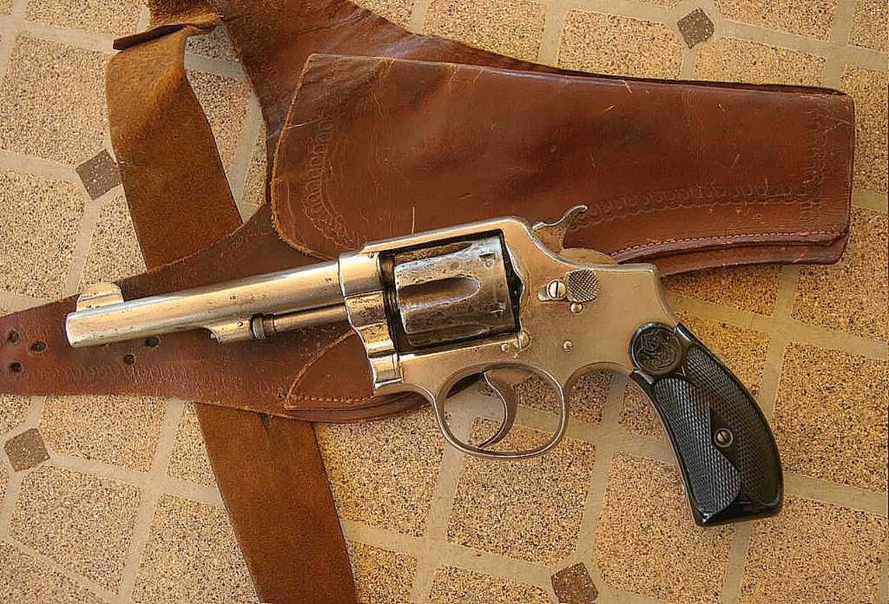

The S&W K-Frame round butt revolvers from 1899 clear until the 1940s were issued with either walnut or hard rubber stocks. Good reproductions of the hard rubber stocks are available from N.C. Ordnance. Either their number G-29 or G-31 fit the round K-frame guns. These are shown for the Model 1902 (G-29) or the .44 Double Action (G-31) but the only difference between them is the size of the diamond around the stock screw. I have bought these stocks for several of my own round butt K-Frames and they work well and look good. I particularly like them on my 2" M&Ps.:D:D

I believe the current grips are Franzite target grips. I think they are ugly and detract from the gun personally.
Appreciate the link to NC Ordnance, I was looking at some on triplek.com, hard rubber reproductions.
