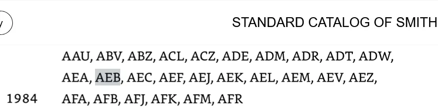

Thanks for the quick replies Gents! Serial is AEB2044. A.I. says 83’ and Jovino’s were 84’, from what I’m seeing. It came with the pachmayr’s. I just put the diamond walnuts for pics they are little off around edges. I’ll prob shop for some period correct grips I bet they will fit cleaner.
AEB equates to 1984 according to my book, too. That Mod. 60 looks very nice. I'm not knowledgeable enough to know what grips were commonly used at that time.
1984 – AAU, ABV, ABZ, ACZ, ADE, ADM, ADR, ADT, ADW, AEA, AEB, AEC, AEF, AEL, AEM, AEV, AEZ, AFA, AFJ, AFK, AFM
Supica, Jim; Nahas, Richard. Standard Catalog of Smith & Wesson (Standard Catalog of Smith and Wesson) (p. 491). (Function). Kindle Edition.
