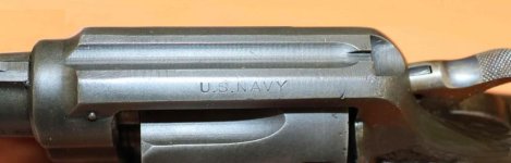

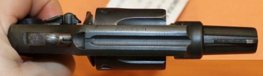

Hey guys what do you think about this Military & Police with 2 " barrell, US Navy marked? I don't know much about duty revolvers, I would like to know something about it. They ask for 800 dollars, please give me your opinions?
Has the barrel been changed? Shouldn't it have a half-moon sight?
SN V238375

Thanks, problem solved, I would never buy a collectible revolver with a replaced barrel, not even for $100.
I think it would depend on who rebarreled it, why and what documentation exists..For example if it were documented to have was rebarreled for OSS use, etc. that would be much different than Jim's sporting goods doing it on their own.
There was a post-war rebuild program for Colt Commandos and quite a few had their original 4-inch barrels swapped for 2-inch. The rebuild program for Victories did not change the barrels unless it was a new 4-inch barrel for one that was damaged or worn out. Also, the top strap markings would have been changed to the then-current Ordnance standard. The OSS was disbanded immediately after WWII and they did not use 2-inch Victory Models during the war.
It's a modern two inch barrel. Not period correct.
