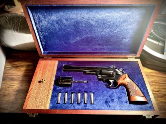

As a side note… I had “GoofyMastiff” make me this case last year.
Not a collector item but certainly something for an enthusiast.
