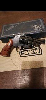

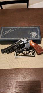

I grabbed a 28-2 4inch highway patrolman at my local pawn shop . It came with original box also the paper the gun was wrapped in and it was in very good condition all original. I'm looking for some help trying to get a manufacturing date our any info you guys might have on it i would appreciate the help. Serial # N275xxx. Thanks.

Welcome to the Forum! Lots of Model 28 (and Highway Patrolman) fans to be found here, as well as a wealth of information. I have three Model 28-2s from the same time period (N200000 to N299999; 1974-1977) and they are outstanding revolvers. Nothing fancy, but they're built like tanks and fun to shoot. Both the revolver and magna wood stocks of your new acquisition appear to be in excellent condition, and so does the box. The prices for Model 28-2s have been skyrocketing lately, so hopefully you got a good deal at the pawn shop. Enjoy!
4" N213329
4" N255229*
6" N275854*
*According to the "SCSW 5th Ed.", approx. the last half of the N200000 range and most of the N500000 range consists mostly of M28s and M58s. After 1980, the M28 serial numbers were merged with the other N-frame s/n ranges.

Thanks for the information I appreciate it all . My dad had a 6 inch highway patrolman and I loved it so I was looking for years for a 4 inch one and hit a jackpot on this one I paid $800 i believe it was a fair price to pay for everything original and in in great condition. Was that a good price to pay? . Also those original grips i have do they raise the value any, not looking to sell it just trying to get a worth on it if you guys have info on that as well.

Looks like a winner to me! You can't go wrong with a 4" Highway
Patrolman, and they are going up in value, especially lately in the 5th Edition of the Standard Catalog.
Larry
Carefully remove the stocks and see if the guns serial number is stamped into the wood of the right hand panel. Based on it's near-new condition and completeness I would guess that it is. Having the original stocks would definitely help with the gun's value.
If the number doesn't match or isn't there, then they were swapped out somewhere along the way. Not a deal breaker so don't loose too much sleep over it if that's the case.
