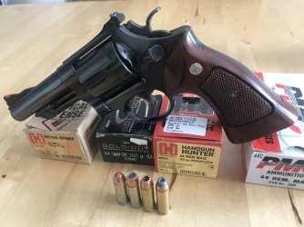

Just curious. How many here shoot Model 29-2s and what ammo do you use?

Thank you, all, for your responses. My 29-2 is about the same age. I haven't fired it in years. I cleaned it and put it back in lockup after some unsuccessful testing with a new bullet. My chamber throats measure .432. I used a commercial cast 250 grain .431 "Keith" SWC with "moderate" loads of Unique, Accurate #5, IMR 4227, and 2400, all with published data. Never full-power. (Example: 10.0 grains of Unique.) Sticky extraction with all powders tried! I had to give the ejector rod a smack with my hand to eject the empties. Leading! I backed the Unique load off down to 8.5 grains. I still got sticky extraction, and, nasty leading 2-3" forward of the forcing cone. I never had issues with 250 SWCs in the (distant) past. I'm getting the urge to "play" with the gun again and was curious about what other shooters are using. Shall I try a different caster's bullet, at .430?

I found .432" cast bullets work best in my 29-2 and 29-3; same for my 24-3 .44 Special guns. .431" is a close second. I wouldn't consider anything smaller for my guns. Leading in the forcing cone and bore might be the result, not to mention a possible loss of accuracy. I also like to use the softest bullet that won't lead, but the alloy isn't as critical as bullet fit.
