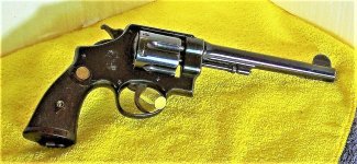

2nd Model HE .455
I thought my post was long enough without going into the possibility of a .45 Colt conversion. :)
Besides, the chambers would also need to be lengthened. Looking at them, I'm thinking they weren't. but some of you may have better calibrated eyesight. In any event, that would make the "unaltered" statement even more obviously wrong.
I agree, the cyl rear face has clearly been 'turned off' with a lathe for greater head space. Whether it's larger enough for 45 ACP or not can only be guessed from a photo. It needs to be measured. We also can see if the recoil shield has been shaved or not.
I also agree the chambers do not appear to have been reamed for 45 Colt because there's usually evidence of the original shoulder still showing unless reamed a bit oversize.

More on my .455 HE
All, thanks for the great info, knew I could count on you. I have examined the gun again and I completely overlooked a proof mark on the bottom of the grip. Also, based on questions raised, I am posting a few more pictures, serial numbers, caliber check, and one with my M1917.
I checked serial numbers, they match on the grip, barrel flat, back of the cylinder, and inside of yoke.
