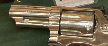

So I got a look at the other side in the case today and I see no flaws in the nickel. It has blued sights with a white outline rear and yellow insert in the front ramp. It is P&R, TH, TT , CC hardened on both,with smooth Magna stocks no checkering. There is a FAINT turn line and a Tyler grip adapter. One thing I noticed were a pair of pins in the barrel rib underneath the front sight base. They appeared to be the same size pin as the barrel locking pin. I don’t see that on Doc44’s gun in the pic he provided. This is maddening…..
So I got a look at the other side in the case today and I see no flaws in the nickel. It has blued sights with a white outline rear and yellow insert in the front ramp. It is P&R, TH, TT with smooth Magna stocks no checkering. There is a FAINT turn line and a Tyler grip adapter. One thing I noticed were a pair of pins in the barrel rib underneath the front sight base. They appeared to be the same size pin as the barrel locking pin. I don’t see that on Doc44’s gun in the pic he provided. This is maddening…..
I’m guessing that with the TH, TT and pinned front sight it is a shortened 4+ inch revolver. I’m also guessing a not original nickel job.
FWIW, I have a factory nickel 2 1/2” 19-5 and it has a black rear sight, no white outline, case colored hammer and trigger. The front sight is nickel, which the previous owner painted white. The cylinder has the N stamp indicating nickel from the factory and the hammer and trigger appear to have been polished to remove/minimize the case colors.
I’m almost positive the grips on the one you’re looking at are not original.
A couple of photos would go a LONG way to answering Qs.
See a photo of the factory nickel 19-5 below. Thai combats added, it came with Pachmayer’s, original grips were probably round butt magnas.
No ramp for the front sights.
Edit for clarity: Meaning, no integral to the barrel ramp. The ramp is part of the pinned front sight.
