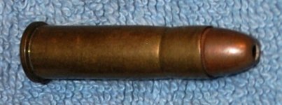

Over the years, numerous posters have asked about what ammo is safe in .32-20 revolvers. I was digging through some ammo and came across this box of Remington .32-20. Note that it is labeled Express Rifle. However, on one of the side panels, it states these cartridges are for arms chambered for the cartridge. Shown is a round loaded with a lead bullet. Remington also loaded this cartridge with a jacketed soft point bullet. Both are safe in good quality, good condition revolvers. Winchester loaded their revolver safe .32-20s with a copper washed lead bullet.
Also shown is a picture of a .32-20 High Velocity cartridge, loaded with a 80 grain jacketed hollow point bullet. This is a RIFLE ONLY round, intended for the Winchester Model 92 and Marlin Model 1894 lever actions and not for the older, weaker Winchester Model 1873. Photo courtesy of alk3844.

All the .32 WCF ammo (.32-20) I've seen in this thread are safe for handguns. I can't speak for specialty manufacturers like Buffalo Bore, but mainstream manufacturers haven't produced "rifle only" ammo in at least 80 years.
