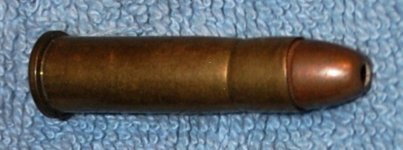

Here is a picture of a high speed .32-20 cartridge, courtesy of alk3844. Note the jacketed hollow point bullet. IIRC, the head stamp is .32-20 HV (high velocity). This round hasn't been produced since the 1960s and was restricted to STRONG .32-20 rifles, such as the Winchester 1982 and Marlin 1894, NOT the older 1873 toggle actions.
