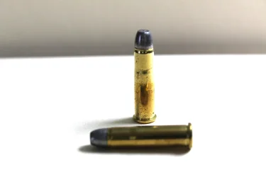

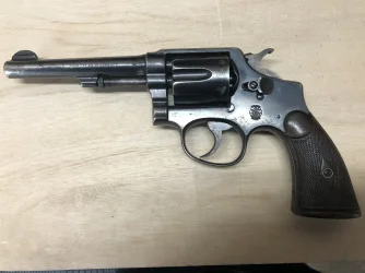

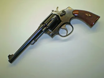

Here is mine, shipped October 1921 per S&W Historian. Condition is everything, especially with these real oldies. The ammo is extremely hard to find and quite expensive when you do. I don't reload, but I sure save the Starline brass that my HSM factory ammo is made with.

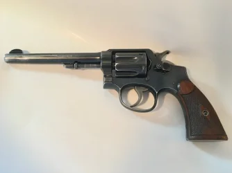

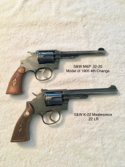

In the early 1920s, S&W changed the right side barrel caliber stamping from ".32 WCF" to ".32-20 CTG". My 6" .32-20 HE, aka Model 1905 4th Change, is ca. 1924 (s/n 118705). 1905 4th Change revolvers were manufactured from 1915-1940 with 4", 5", or 6" bbls. I'm thinking that yours was manufactured sometime in the early to mid-1930s, and its value would depend upon condition and features. Pictures would certainly help to better ID your revolver. Enjoy!

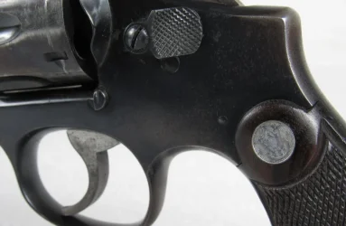

1930 pistols ,, will probably have silver medallion stocks.
And the patent stamps appear First,, ?1928 ? on hammer & trigger.
The low serial number range of the 32-20 gets Very small ((I believe )) and MOVES very slowly after the hammer & trigger stamps ,, start to appear.
Also by the 30’s the Mushroom is gone.
I’ve found 32-20s started getting H&trigger stamps in the, 135,xxx ish range.
