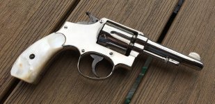

I don’t remember what I paid for the square butt K frame pearls but they are in excellent shape with nice color. I’m guessing just over $100 but just a guess.
The ones on my M&P came with it and I paid $350 for the gun and grips.
They may not be OEM Smith but they’re still very nice grips and look great. OEM Smith if you’re a collector but I’m more into shooting my guns and don’t really care if everything is original.

Wow, I wouldn’t describe that as “nice color”, I was describe it as awesome color! Beautiful!
