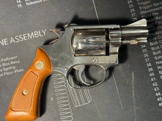

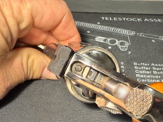

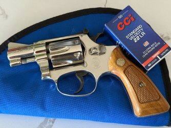

I picked up a very clean 34-1 and found it doesn't always fire. I have to go twice around the cylinder to get all rounds o fire.
Used CCI SV ammo.
Cylinder locks up tight and appears to be inline with the bore on each hole in the cylinder.

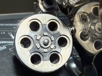

First pic shows, what I think, are firing pin divots hitting the cylinder. Is that correct thinking?
Any ideas how to fix this non-firing issue?
View attachment 761924View attachment 761925View attachment 761926View attachment 761927View attachment 761928View attachment 761929
How's the CCI SV go through your other .22s?
CCI had a bunch of quality control issues about the time they changed to the new box art.
With the new CCI, I'd regularly have to 'go round the world' a couple of times in my Outdoorsman to touch off the whole cylinder. The problem went away when I found a brick of old SV.
Ammo may not be your whole issue, but it wouldn't be helpful in diagnosis.
Mostly happens in double action.
I run mostly CCI SV in all other 22's, especially suppressed.
