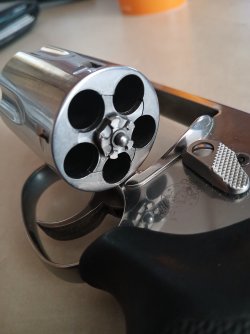

If when you are pushing the release forward and moving the cylinder out, the release stays forward is normal. If the cylinder is still in the closed position and release stays forward. Oil's can sometimes get crusty and bind up the center pin. Here is a picture the pin in the center should move inward and return with a pretty good spring load.
