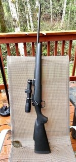

I couldn't find a lever in .356 so I made one.
I got a deal on an older Glenfield 30/30 that had some surface rust and a water damaged stock. The rifle had been put away in a damp case.
I tossed the stock and sent the barreled action to Jesse Ocumpaugh in Oregon who did an excellent job reboring, rechambering to .356 and test firing.
When I got the barreled action back I sandblasted the light rust away and Cerakoted the metal in Sniper Grey.
Ordered a 336 Deluxe stock from Marlin for $180 and the new .356 was taking shape.
I worked up a load with the Hornady FTX and A2015 powder.
It was sub MOA out of the scoped carbine, and I was certainly pleased when I shot this 300 yard target.
