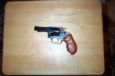

Never paid any attention to it but since my 36-1 has a sn that is all numbers, that, according to what I've read, places it at 1969 or before. Problem is, I bought it new and in 1969, I was 15! Bought this SOMEWHERE around 77-79. Is it POSSIBLE that this sat on the shelf for 10 years and never sold until I got it? Just curious. Lovely little firearm and it's still carried occasionally when I need to go light.
Possible. It could have also sat on a shelf at S&W, hiding behind a box of something, and didn't get shipped for ten years. Unlikely, but not impossible. Are you SURE you bought it new, as in never previously sold at retail?

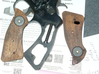

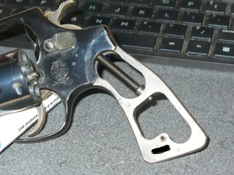

Under the stocks there are some manufacturing changes that ought to narrow production to post 1977 or so. Likely it has the flat spring strut and the disk washers are in the white.
Grips have never, to my knowledge, EVER been off this gun until just now. Have only fired MAYBE a box of ammo through it. Needs to be cleaned though!

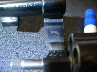

Interesting. I suppose those who speculate about such things could come up with a plethora of "whys" and "hows." I believe the star at the bottom center of your photo in post #10 suggests the gun went back to the factory for some work at some point.
The number you blacked out in the photo in post #10 is an assembly number. You should (dangerous assumption) see that same number on the yoke in your photo in post #8.

This post has a photo showing magnas that were fitted at the factory and have the black disc and stamped number on the right stock.

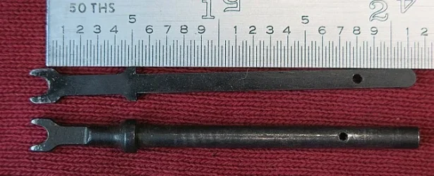

The strut will be very hard to see in a photo. Look between the coils to see if its flat or round, or even easier, with side plate on cock the hammer and you'll see the top. Most likely flat
My notes are the flat strut (aka stirrup) first appears in the 1977 part lists.

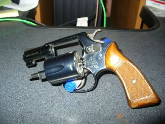

The serial number on mine is estimated to ship is 1975 and yours has a higher number.
Mine had the flat stirrup but it was bought used so it is not a reliable benchmark.
If you mean the assembly number, they both match. What washer? You mean the spacer at the BOTTOM of the strut that stops at the frame, it's bare metal, not black. My sn has NO letters, just numbers.
The washers on the stocks shown in this guy's photo

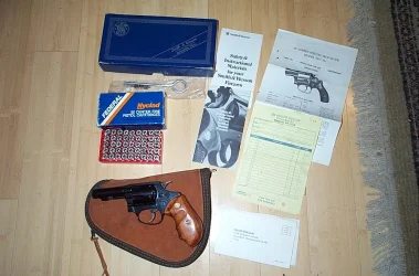

Mine is a bit later than yours but came as a package with the matching receipt and even the same box of ammo purchased with it. It appears to have been shipped with these stocks when new. The receipt dates a few years later than the serial number indicates it was made but it didn't matter to me. Came with the period rug too. $500 for the package about 6 years ago.
No J serial number, black discs, round stirrup, non-diamond magnas all pointing toward supporting your belief that this revolver was made around 1969. All we can do is guess that it got sent back and had a 2" barrel installed. So maybe it was "like new" according to the dealer. Did it come with a box and accessories?
I honestly don't remember if it had a box with goodies or not. I THINK it did but that was over 40 years ago and it was just a gun then. I was carrying a Taurus .38 when I worked nights at the store by myself and wanted something lighter so the 36 was perfect. I remember being TOLD it was new but I HAVE been lied to before! It was a reputable dealer and I can't imagine a reason why it would have been re-barreled but unless I get a letter from Smith, I won't KNOW for sure. Sure doesn't LOOK like it's been altered but who would know!
