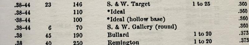

I'm finally going to get out and do some shooting this Friday with the boys. One of the guns I'm bringing is my Antique NM3 "Long Frame" 38-44 Target gun. Been dying to shoot this with original target loads.
The only piece I couldn't match is the original case length. So, it's as close as I can get. I'm using an original bullet design/Ideal mold seen in photo 1 of the early target .360/146 grain round nose target bullet, original load of 23 grains of FFFG (American Black Powder), and Winchester primers. NO case crimp applied. See photo 2. These are "match loaded" cases. By that I mean the bullets were weighed and match within 1/10 of a grain, powder weighed, matched cases and primers. The cases are fire formed to .360 so no bottle neck throat is seen on the final product. The .360 bullets fit perfectly snug without a crimp.
I'm also going to try some .360 wadcutters at the 20 yard target with reduced FFFG loads. If by some miracle I shoot well, I'll try the round nose rounds full loads at the 50 yard mark and record results. Likely laughable but we'll see. I'm also going to use a "RED DOT" bullseye center just because my aged eyes need all the help they can get.
I also seated the bullet to reside within 1/32nd of an inch from the face of the cylinder. That should produce some excellent results at the range. I'll take photos of the target, range, etc and post results. Don't expect much from my aged eyes. I'll do the best that I can, but the good days are gone.
