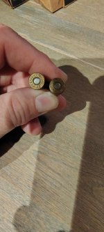

I have some old ammo, I thought the comparison would be cool. Both are by Remington, the Colt is Flat nose, 150gr, the S&W is round nose 146gr. The wording on the side of the box is reversed. The Colt is stamped NP, for new police. I plan on trying it tomorrow.

That ammo - both boxes - is 38 S&W caliber. As such the velocity should be pretty low, like under 1000 FPS for both rounds. A chronograph would be interesting.

Why? The .38 S&W and .38 Colt New Police are the same cartridge except for minor differences. Those differences are:
Bullet weight, (slight)
Bullet shape, (insignificant)
headstamp.
The exact same situation exists with the .38 S&W Special and the .38 Colt Special and the .32 S&W Long and .32 Colt New Police. It was a marketing thing plain, simple, and silly:D.
Why would you want to shoot up what is basically antique ammunition?
I'll look up my chronograph data later but remember the velocity of factory ammo around 650-675 fps out of a 2" Smith Terrier. They're a lot like a mild 38 special and low recoil even out of the little terrier. Although not the most powerful cartridge I'd still consider it viable if you have an issue with recoil. It probably exceeds 32acp and long and comes close or exceeds 380 acp in energy. The biggest issue is a lack of bullet choice if you're looking for the correct diameter bullets of .361 to reload. Some people use .357-.358 for reloading and have read hollow base wadcutters work well.

.358 bullets work fine for reloading the .38 S&W. I have fired thousands of them.The SAAMI minimum bullet diameter specification for the .38 S&W is 0.355". For use in a solid frame revolver, .38 S&W can be uploaded easily to equal the ballistic performance of the .38 Special.
