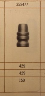

Got out of the house today and drove out to BLM to test some loads with the excellent 358477 SWC in 38 Spl +P:
Firearm: S&W Model 10 4” (cylinder to barrel gap .008”)
Bullet: Lyman 358477 155 grs
Cases: Starline 38 Spl +P
(All 10 shot strings)
Load #1: 38 Spl +P, 6.5 grs HS-6, Winchester Small Pistol
