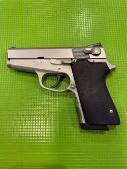

Do mags for the Model 3913 fit and function in the Model 639? I guessing yes IF they are the same length, but I've been wrong before! TIA!
NO the 3904/3906 replaced the 439/639 as a "full size" single stack 9mm. The 3913 was a compacted version with a shorter 8rd magazine which ultimately replaced the short lived 3904/3906.
The 3904/3906 mags may work in a 439/639 but they had plastic baseplates and the 439/639 had metal baseplates - as I recall there is a slight gap at the bottom of the grip when using the mags with the plastic baseplates in the 439/639 and earlier 39-2 pistols.
when I got my 3913 the guy had 5 mags. 3 for it and 2 639's that worked. when I got my 3906 the 639 mags were a no go so I sold them and got more 3906 mags which also work in the 3913.
The longer 3904/3906 (or the 439/639) mags can be used in a 3913/3914/3953/3954 but they will stick out - but the shorter 3913 mags can NOT be used in a 3904/3906/439/639/39 which was the OP's question.
