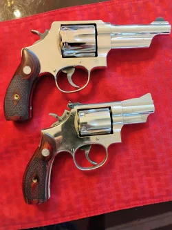

I only have one MIM revolver, a 20-4 that I really like and since it didn't have a key, I never think about the lock. Below with my 19-5 which is my current EDC.
