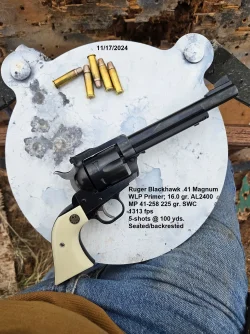

I use 7.8 gr. of Titegroup with either a home-cast 210-ish gr. SWC or a commercially cast SWC of the same weight. Velocity is about 1150 fps and the load does quite well on hogs.
I've also loaded 10.5 of Longshot with the same bullet in addition to a 220 gr. Keith SWC. Velocity is right at 1200 fps and this load is very accurate at 50 yds. The only heavier load I use is 16.0 gr. of 2400 and the 220 gr. Keith SWC. Velocity is just under 1300 fps out of a 4 5/8" barrel and just over 1300 fps out of a 6 1/2" barrel.

Using any 210-220 gr cast / plated / jacketed bullet 7.0 grs of Hodgdon's Titegroup works well for mid range , 7-7.5 grs of HP38 / W231 ( the same) is another good mid range load . When I want more I use 17.0 grs of 2400 . Berry's Bullets makes a nice 210 gr plated bullet . I seat it till the shoulder is about the thickness of a dime above the case mouth over 7.0 gr of HP-38 for a real nice shoot all day with power / clean shooting combination . Regards Paul
