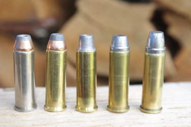

I've got a bunch of 225-grain LSWC Keith-type bullets and I'm experimenting with H110 and will be with Accurate #9. Pal of mine says he loads this bullet over 18.0 grs of H110, but another pal says that's a light/low pressure load for H110. I've loaded the bullets over 18.0 grs and they aren't consistent. Is there any GOOD source of data for this particular bullet (last one on the right).
