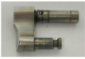

The Smith design ejector rod running on center of the cylinder requires a larger frame and cylinder to match in order to increase barrel shank diameter and it clear the ejector with its gas ring on cylinder.

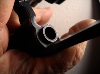

Ruger ingeniously side stepped this assumed fact by using a two-piece ejector rod assembly with front section offset lower when cylinder was latched, leaving them more room for a larger diameter barrel shank and thicker walls to the forcing cone of shank. Also, I should not be suprised to find Rugers having less unsupported shank protruding from frame, and a steeper angled cut leaving more thickness.
