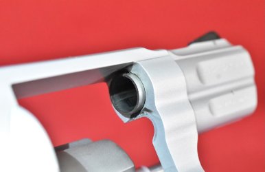

On thing that is interesting is how thin the barrel is at the forcing cone on a 296 Ti and how thin the cylinder wall is.
The 296/396/696 family's weak point is the forcing cone, not the cylinder's thickness which being a five shot has offset stop notches which don't reduce their thickness any & are robust enough of for hotter than standard 44 Special SAAMI loads. The M69 fixed the FC weakness issue.

396NG FC
M69 FC

396NG FC
M69 FC

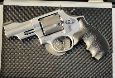

My 396 says 200 gr bullets, but I occasionally shoot 240 gr cowboy loads with no problem. If I want to push things a little, I pull out my 24-3 .44 spl Bisley or a 44 mag. 😇IMG_0111.jpeg
