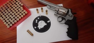

I'm really satisfied with my reloads below in
my new to me S&W 657-4.
210gr .410dia #41000 Hornady XTP/Alliant
Red Dot 7.2grs/CCI #300 LP/ Starline case.
Crimped light. 900fps?
215gr .411dia SWC Hi-Tek Red coated Acme
Lead bullets/Winchester HP-38 7.0grs/CCI
#300 LP/Starline case. Crimped light. 900fps?
I shot up the small sample of reloads I had.
This time I used a table and a padded kettle
for support.
In a vintage lawn chair, I sat behind the
kettle, with arms on the support extended
forward, with wrists unsupported, and
aiming at the target.
Before this I contemplated moving the rear
sight, I'm glad I left all alone.
Carefully aiming and squeezing the trigger
the Acme SWCs shot right above center.
The 6 Hornady XTPs shot the same, a tighter
group and two bullseyes.
These groupings were better than the 3"
low and 1" to the left I was getting.
I think what I was doing in the standing offhand
position was pulling the shots down
or not squaring up my sights correctly.
Very pleased with my reloads and revolver.
