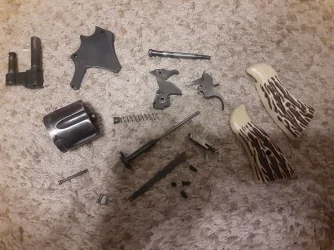

Found the barrel and frame with a few parts installed in one of the boxes. In another box I found a zip-lock bag with most of the other parts. Had to buy a few. Y'all were very helpful. Just from the pictures I took I got a list of the parts I needed and where to get them. A lot of knowledge here.

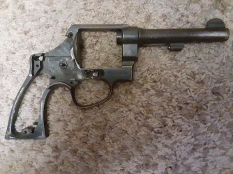

The trigger guard was bent to the point you could not pull the trigger. The frame was bent so that the barrel pointed up at a bit of an angle. Prevented the cylinder from properly closing. Had also been refinished and not a great job.
My local gunsmith wanted quite a bit to get it going. A forum member from Oklahoma said if I would send it to him he would repair it at no charge. Much appreciated.

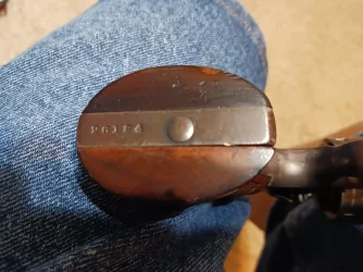

After all was completed I asked the group if I should get a letter. The general consensus was no. Said the gun was not in great condition and probably all I would find out was what hardware store it shipped to. Our Historian Don Mundell kindly gave me a hint that the gun had been shipped to an individual. Ordered the letter. The gun did not have a butt swivel and had been plugged with a domed plug. Asked the group if they thought this was done at the factory. Again the general consensus was no.
.44 Hand Ejector 2nd Model, caliber .44 S&W Special with butt serial number 26184 shipped June 3, 1926 and was delivered to Frank Gamblin, Deputy Sheriff Potter County, Texas. Shipped with 5-inch barrel, blue finish, fixed sights and checkered walnut non-medallion square butt grips. On the invoice it says "Do not have rings in butts", so I think the domed plug was probably done at the factory.

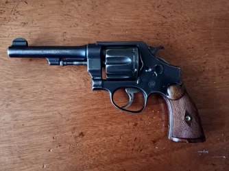

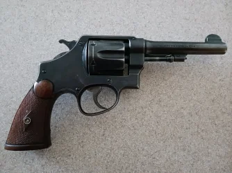

All numbers match except the grips. The assembly numbers match. It is a good shooter. 100 years old this month. Not very pretty, but I like it because it belonged to my dad and has LEO history.

The trigger guard needs another "pull" to get it to proper shape.
With grips off, clamp tightly in a vice with padded jaws. Cock the hammer.
Place a 1" x 6" wooden dowel thru the trigger guard and give it a hard jerk.
You'll be surprised how easy the trigger guard will move.
If you have another N frame compare the trigger guard shape.
Being a 2nd Model fan, I think what you've done is great, good job. I have a friend that was sent back to Smith & Wesson armor's school. He has a couple jig sets to straighten frames and such and has done wonders to a couple of my old revolvers that had been tweaked by harsh use or accidents like dropping. As was mentioned you would be surprised at how easy they can be tweaked in a positive or negative way.

I suspect that 44 was built on a 1917 surplus frames which could be why it was drilled for a lanyard ring. But it was ordered w/o it so it has the factory plug in the hole, retained by the same pin that was used to retain the lanyard swivel.
If I'm guessing right, there might be an inspection stamp in the yoke cut of the frame that looks like an eagle head with beak pointing skyward.
That's a safe bet with any round top 44-2nd shipped after WW I. ;)
