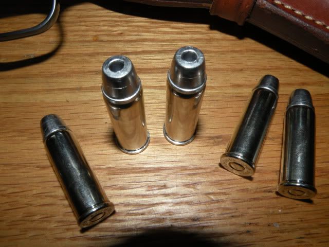

Here's some of my home-cast 429244 gas-check hollow-points in nickel W-W cases loaded with 17.5 of AA-9. These were put up for my hunting loads last year. Didn't get a deer but they did account for a coyote out of my 5 1/2" Redhawk.
If temperatures drop below 20*F in your area, DO NOT USE BLUE DOT at maximum loads.
It is inversely affected by temperature. Colder = higher pressures.
