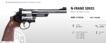

I'm looking at the current version of the Model 25.
I believe it would be the 25-15 version now.
Two questions:
1. Can I shoot 45 ACP with moon clips in it?
2. Is it a conventional barrel like the old days, or does it have a tube-and-shroud arrangement?
I think I know the answer to the second question. At least from photos I've seen, it looks like a conventional barrel from the old days. Unless Smith and Wesson has gotten REAL GOOD at concealing the tube/shroud. Pics of the muzzle of the 25-15 I've seen on various websites look like the 25-15 steel is pretty narrow (as it should be) near the muzzle, and no lines that would indicate a two-piece tube/shroud arrangement such as seen in the Model 69.
This one I'm interested in:
https://www.smith-wesson.com/product/model-25-s-w-classics-6-1-2-blue
Smith and Wesson website simply says its chambered in "45 COLT."
I believe they should have said 45 LONG Colt.
But I'm not trying to nit-pick that detail.
I believe this is the "dash" FIFTEEN model.
But the Smith and Wesson website doesn't mention the "dash" part of it either.
If I get one of these, I'd like to be able to shoot my good supply of 45 ACP ammo in it. Nothing against the 45 LONG COLT flavor. I just don't have a supply of 45 LONG COLT ammo. It would be my preference to just shoot the same 45 ACP target ammo I use in my 1911 guns in this very attractive wheelgun. I don't mind buying the moon-clip paraphernalia to accomplish the task.
So can anybody say for sure whether the 25-15 model will allow use of moon-clips such that I can shoot 45 ACP in it?
Thanks for your consideration and comments.

Although, there were model 25s that were 45 long colt and 45 acp- that newer model would have to be cut for moonclips. It will only take 45 colt.
My 25-2 will only take 45acp and not 45 colt.
The cylinders on both are different.
No, this is a .45 Colt, so will not fire .45 ACP. But plenty of N frame .45 ACP guns out there.
It used to be a model 25 with an even "dash number" indicated a .45 ACP and an odd a .45 Colt, but don't know if that rule holds to the present day.
What Lou said. Cylinder would have to be cut or head space issues. My 25-15 REALLY like it! Bob

Smith and Wesson revolvers that are designed and built to fire rimless Auto Loader cartridges are designed to headspace on the moon clip
That said, probably 85% or more of them can fire ammunition that is placed in the cylinder without using a moon clip. In this case the case mouth is resting on the cylinder throat so the length of the brass and the style of the crimp will aid or hinder the cartridge firing
Obviously it is often necessary to use a rod or stick to poke the brass out of the cylinder.
IF
the firearm fires the rimless ammunition with out a noon clip, this is not by design it is simply luck
The firearm that you have pictured clearly states that it is chambered for the 45 Long Colt cartridge.
When it comes to Smith and Wesson model 25/325/625 revolvers manufactured in the nineties and beyond (traditionally) those that have an even numbered engineering revision, which is what some people call the dash number, are chambered to fire the 45 ACP cartridge. Odd numbered engineering revisions traditionally are chambered for the 45 Long Colt cartridge
So a engineering revision of 15 is chambered in 45 Long Colt as it leave the Factory
As others have stated, a gunsmith can modify that firearm to safely chamber and shoot the 45 ACP cartridge. Such a modification would VOID the Manufacturer's warranty
For most of us it is just easier to buy a firearm chambered for the cartridge that we wish to shoot.
Just remember that with Smith and Wesson every rule has an exception or two
The currently offered Model 25 that you have pictured above utilizes a single piece barrel.
I believe the only 45 caliber revolvers that Smith and Wesson ever offered with the multi piece tensioned barrel design are the Scandium alloy framed Model 325s. This allowed for the use of an aluminium alloy barrel shroud to further reduce the firearms weight
