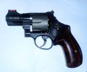

Instead seek a good performing load which YOU can shoot well. Most of the time this will NOT be the maximum load. In my S&W 325PD I load #454424 with 4 grains of Bullseye or TiteGroup which approximate 650 fps from it's 2-3/4" barrel. Your 5 grains of 231 with a 245 RNFP should perform similarly. My loads enable controlled double-taps from a very light (21 oz.) Scadium N-frame gun with manageable recoil. Ballistics approximate the .455 Webley. "A little powda, a lotta lead, shoot'em good, they be dead."

It is necessary to measure cylinder throats and to size bullets accordingly. My 325PD accepts a .451 zz minus pin gage, but not a .452. My 1950 Hand Ejector and M1917 accept a .455 but not a .456.
