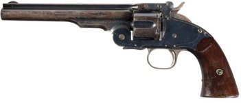

The 45 Schofield was part of the local Militia aka "The Guard" originating from The Benicia Arsenal in the Area that I grew up. See photos.
Over 300 were issued during the Railroad riots of the late 1870's to the local Guard. Likely more were actually in the Armory. I am not aware of any information regarding what happened to them but on occasion some do show up. The buildings are still actually there in Benicia and date before the Civil War.
It's not difficult to imagine a No.5 Armory tool special ordered in the 45 Schofield since it was an Armory reloading tool. The 45/70 Gov and 45 Schofield are like Peanut butter and jelly. Some information uncovered today is not in any books.
