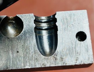

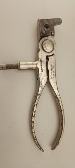

I just picked up this somewhat rare 32-44 Peanut mold. I was starting to clean it up when I noticed the typical matching numbers under the Walnut scales were 4 digit. Most that I recall seeing were 2 or 3 digit. I always assumed that they were assembly numbers.
However, in the Neil & Jinks book on page 216 they list SERIAL NUMBER STAMPED under the wood grip. Assuming this is correct it would be possible to get an idea of how many were actually made?
Maybe those who have peanut molds can carefully remove one scale and post the number they find?

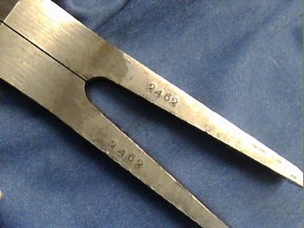

Hi There,

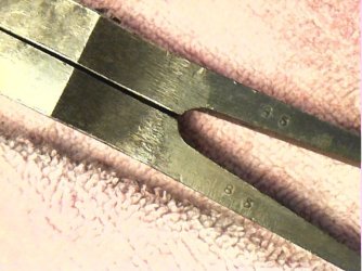

Well, you've got me curious so I pulled the grips off my .38 S&W mold.
My serial number is: 2462. See pics.
Cheers!
Webb

Wow,
That's amazing Webb.
That pretty much solidifies these numbers are definitely serial numbers not assembly numbers.
So now all we really need to know is the highest number we can find and also if they were numbered in sequence by individual caliber or all together as produced without caliber influence from about late 1887-1907ish. So about 20 years of production. 1907 represents the year Smith & Wesson guaranteed their firearms for smokeless use which would have rendered these black powder tools obsolete.

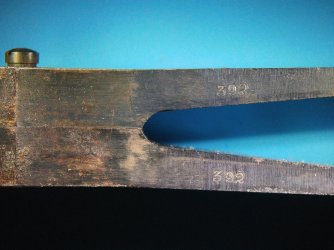

The numbers on the three peanut moulds I have:
416 - part of a boxed set of .38 Military & Police (.38 Special) loading tools. Casts a 158gr RN and a RB;
630 - .38 S&W. Casts a 148gr RN and a RB;
238 - .38 S&W, maybe .38-44? Four-cavity: two on top, two on bottom. Casts four RB.
Jim

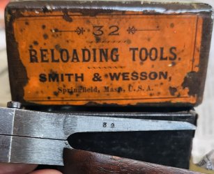

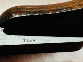

Finally got a chance to look at some additional Peanut molds. One 32 S&W cal with a higher serial # (2137) and a 38M&P with a very low number# (25).
So this relatively small survey actually confirms over 10,000 total made between all calibers and this is obviously way low.
However, it definitely is enlightening. I had no idea.
We have not included any 44 Russian, 38-44, or 4 ball molds for smaller and larger calibers. So quite a few more were made.
I think this also supports just how many folks were reloading ammo back in the day!
Murph

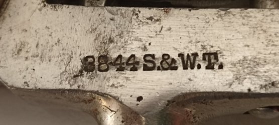

Thank You Danalex,
Your serial numbers continue to support the theory that the molds were serial numbered by individual caliber beginning with 1.
The 44 cal Russian is quite scarce today and your numbers support this position.
Why the 44 cal was less popular in my opinion was due to the overall size making it difficult to carry concealed.
Also commenting on the 1700 serial number range found on the 32-44 Target peanut mold also actually makes sense as Target shooters were and are avid reloaders.
