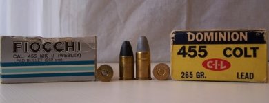

Fiocchi still makes the ammo but it isn't cheap. This box sold at Ray's in Dallas maybe 6 years ago......
