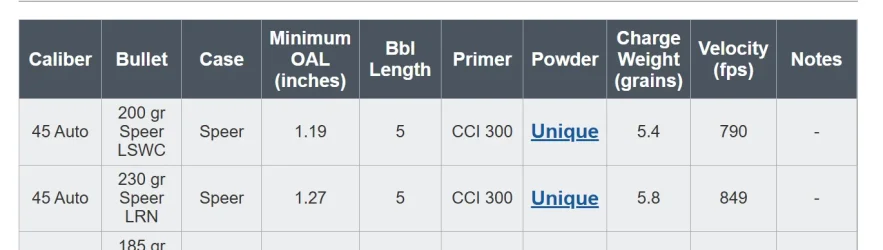

You need to read the first page of Alliant data. They don't tabulate a starting load but if you read the introduction they say to reduce 10% to start.
5.8 grains of Unique, 200gr lead SWC. Offhand 36 rounds,15 yards.
This works in my 1911 and is the only load I shoot anymore.

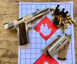

My avatar was shot at 25 yards with a 200 grain LSWC and 3.6 grains of Bullseye. Very low recoil and pleasant to shoot.
Other favorites with a 200 grain LSWC are 3.8 grains and 4.2 grains of Bullseye.

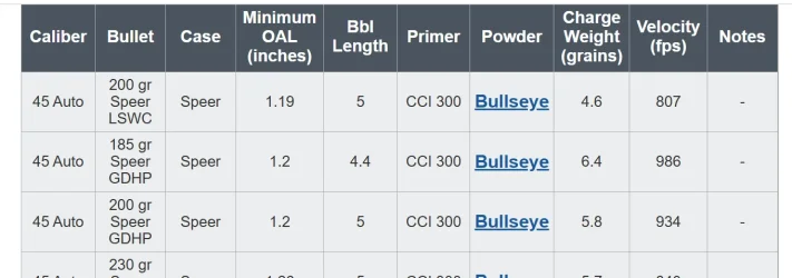

Two excellent powders for the 45acp. My favorites, time tested. The two shine in different sections of the load spectrum. Although both powders can be loaded “all around” I use Bullseye mostly and have a decent supply of it. Right now, hard to get though.
Full power
6.0 grains Bullseye

4.4 grains of Bullseye (200 grain plated) a one hole load @ 25yds with a very tight pistol.
