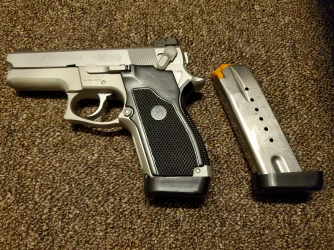

That's a decent price. Some say 69 series mags are spendy or even hard to find but with patience they can be found affordably. Full size 59 series mags work well when you use a PGS adapter. My 669 has no complaints. Its grip panels are the later style that I've heard give just a bit more purchase.
The sights and grip are not as good as found on the 3rd gen guns. Mine was machined for Novak night sights which are hard to beat. The grip remains 2nd gen but I have no plans to modify the frame to fit the 3rd gen Delrin grip.

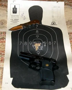

Only had it to the outdoor range once..... 65 rounds...... 10/12 yds 55As 8Bs and a couple Cs. DA/SA double taps. Really short reset on the trigger.
