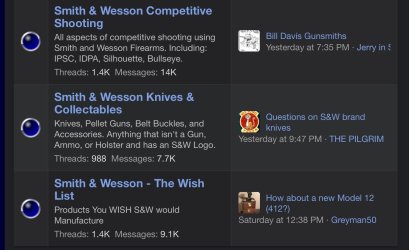

I'm moving this to Smith & Wesson - The Wish List.

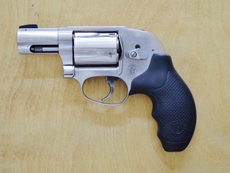

Here's my 649, one of my Go To Guns.
Loaded with 38+P.
